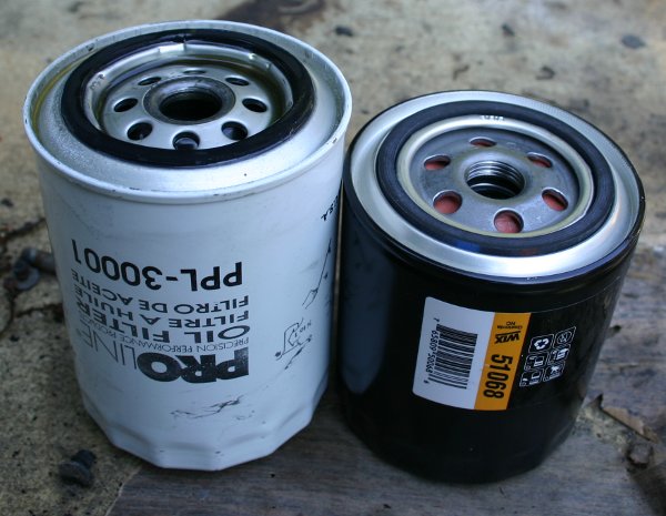

I'm actually not aware of an oil filter adapter that won't work, but you'd probably be best off if you used one of the horizontal, truck-type filter adapters. The vertical type will still work, but you'll need to use a stubby (3/4 quart) oil filter with it to clear the crossmember. If you're curious to see photos of this and hear about specific part numbers, let me know and I'll provide that!CO684X4 wrote:Also what oil filter adapter do I need to put this in the 2wd?

One benefit of the vertical adapter and short filter is that you'll spill less oil during oil changes (I think).
Thanks for that photo of the pan! Indeed, you'll need to test it. But my guess based on the photo is that it will work fine! It doesn't look much deeper than the factory front sump pan.CO684X4 wrote:It is an aftermarket oil pan. Here is a pic of the pan. Guess I will have to test fit it to see if it will work.
I think this is the case. I also have (had) a vertical oil filter adapter in my truck, and I used a WIX 51068. Here's a photo of how the WIX 51068 looks next to a stock oil filter:CO684X4 wrote:I have the vertical oil filter adapter. So if I use a shorter filter I should be ok?
