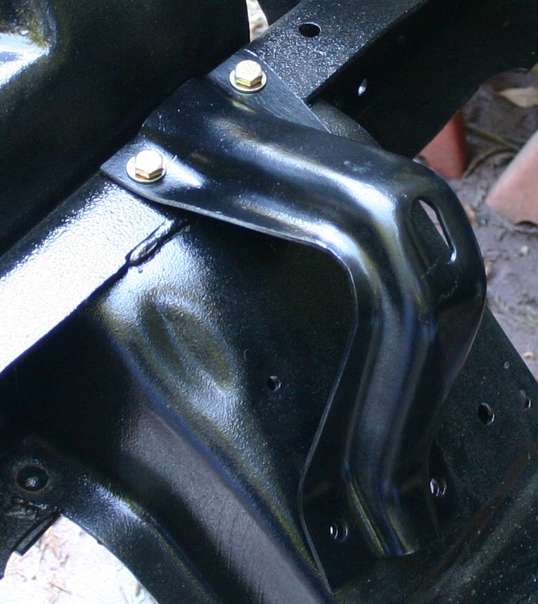

Good morning,
I'm re-installing the engine mount towers on my frame, and am getting trigger-happy with all the nice Grade Eight hardware I see at the store.
When I pulled the towers it looked like the factory used a simple bolt and nut combo to mount the towers, yet I've been thinking that washers and/or lockwashers would be a good addition.
Is there any reason not to use washers on these mounts?
Thanks!

Can't see any reason why not, that is definetly not something you want to ever come loose. IMO the more secure the better for the engine towers.

lock washers on the nuts will be a good idea. i was thinking they originally had them with the nut. but maybe not. the flat washers really wont do much for you. those are mainly like a shim if the bolts arent the correct sizes for the holes. they also can act as a anti pull through device if there was a chance of the bolt pulling through the perch holes. if you have power steering and the wrong perch you might not want or be able to get a washer on the top rear drivers side bolt. it could interfear with the remounting of the steering box.

Ford liked those pinched locknuts but I see no reason not to use lock washers. I am like you, I love those grade 8 bolts and I have got where I buy them for almost everything. Grade 5 at least and hardly ever the common ones. One thing I do is drop a size for the flat washers. If you get a 3/8 washer for a 3/8 bolt, they are sloppy but the 5/16 washer fits nicely on the 3/8 bolt. Same with the other sizes too, almost always I drop a size for the flat washer.

From experience (industrial) you don't use both a washer and a lock washer together. The washer will limit the effectiveness of the lock washer because the washer 'slips' and can allow the nut to back off even with the lock washer.
In that application I'd never use a lock washer beause under loads and vibrations they tend to split apart making the bolt / nut sloppy loose.
Another area for concern is torque ratings on bolts. Don't tighten it till you fart or it will fail down the road. Also zinc coated bolts have different torque ratings vs standard uncoated bolts and oil really screws with the torque values.
If you want to put it together and not worry about it either reuse the original hardware or get some Nordlocks;
http://www.nord-lock.com/
They are two special serated washers that grip the nut and part and have serations that pull a heavy load to remove the bolt. They work extremely well.

It all depends on how tight you put them together. One nordlock per bolt, on the nut side. Usually tight :thup: putting together equals tight :cry: coming back apart. You'll get the feel of one when you try one out. You can't reuse them though. I did the exhaust and intake bolts on my projects. Carb bolts too. These things are worth every penny for the exhaust because they don't loosen when the plumbing heats and cools.

When installing the engine mount tower bolts, would you recommend using a washer under the bolt head and a Nordlock under the nut? Or no washer under the bolt head?

As long as the bolts fit nicely in the towers I would not install the washers. I the tower holes are washed out I would consider grade 8 washers. Nordlocks at the nut.

Re: Should washers and/or lockwashers be used on engine towers?
