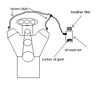

This is a rough sketch of the little breather system I saw on horsepower TV today on my engine. Yeah, it is a pretty fantasic depiction of my motor, i know. Anyway, I thought it was a pretty cool idea that I'm planning to use on mine in place of the PCV system. The hoses run into a reservior to catch all that messy oil film while still allowing pressure to escape out the top through a regular breather filter.

for that to work on our engines it needs to have a in and an out. you cant have two outs. so it will have to be routed different with those hoses. one hose has to go in and the other has to out to catch the oil that may build up in the bottom of that bottle.

I think the idea is to hope you're not pumping staight oil out the vavle cover so the canister only catches that small amount of oil film that would otherwise end up on the valve covers and down the side of the block. The "out" is the filter on top of the bottle. I'm pretty sure if it's so bad that you'd need an oil return line out of the bottle, you may have other problems. Either that or mine is out of oil or gave up on pumping it to the top of the motor.

Re: crankcase press
that bottle is the out yes. but where is the in for the air to help evacuate the crankcase? you have to have two seperate lines. not one merged together.

Re: crankcase press
Fordman, I think one of us is confused. I'm assuming that because you are 100% FORDified and have almost 22000 posts, you might have a little more experience than I do in FE's, so more than likely I'm the one that's confused. Would the gap in the rings that allows pressure to sneak by into the crankcase not be the in you're talking about. I don't know. This is about how it was set up on my magic picture box, but then again, you can't believe everything you see on TV. If I'm wrong in my thinking, PLEASE, tell me. I joined this sight to learn, and try to spead the little knowledge I have.

The TV is not wrong on this case the engine must have air coming in at some time. The engine breaths out as it warms up and breaths i when it cools down. A normal engine always breaths in and out as it runs for the PCV to work. A lot of engines breath out when running due to ring blowby and valve guides leaking, Mostly exhaust. Because those hoses do not contain PCV valves or a check valve anywhere the engine will breath in and out. If there was one PCV inline in the hose after the Tee or at the tank then the engine could only breath out.
You don't have to have a PCV valve. It performs 2 functions when hooked to the manifold. It allows the engine to suck the oil fumes out and burn them. It stops a backfire from blowing into the engine and destroying every gasket and seal. So if it is not hooked to the engine and not hooked to positive pressure then it does not need a PCV valve. Boy is PCV(Positive Crankcase Ventilation ) hard for me to get out. I work with PVC (Poly Vinyl Chloride) pipe for wiring. Just today I typed PCV instead of PVC in the accounting system because I have been reversing my letters for this conversation.

Re: crankcase press
if the rings are bad compression air and gases can get into the crank case. the pcv system on our trucks is a cycling system. it is kind of a non ending loop. in our trucks the air gets brought into the enigne via a valve cover breather. on the other valve cover is the pcv. is is hooked to manifold vacuum. the manifold vacuum sucks the air out through the pcv. the fresh air for the pcv is sucked into the crankcase by the other valve cover breather. so if you were to run both valve covers to one hose and then into a jar can or bottle you would have a road draft type of set up kind of. which the road draft set ups were even more dirty than a pcv setuyp. and the pressure would not be sucked out it would be pushed out of both valve covers. and anyplace else it wanted to push it out of. like the dip stick tube or a leaky oil pan gasket or a valve cover. one valve cover needs to be open to get air into the system so to make it cycle. up and outinto the jar. or a suction hooked into the jar to suck the pressure out. the crank case really needs this in and out type of system. i dont have tv anymore. could you point me to the show on the site you saw. which episode i mean. then i could check out wht they were trying to say.
