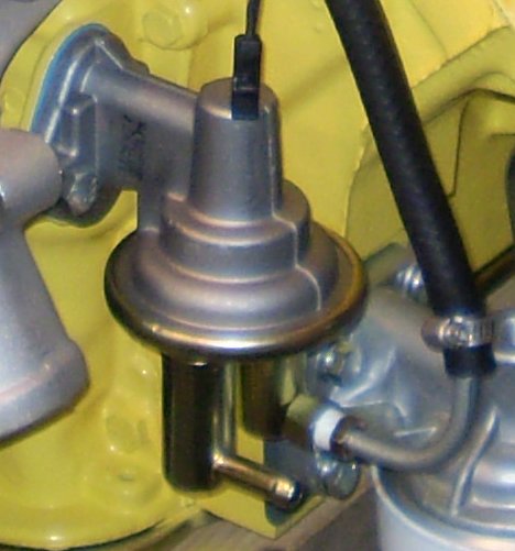

Hi SideoilerFE! Thanks for your reply. I think the fuel pump on my engine may not have a canister--is this likely? Here it is:
Thanks!

You don't have the stock pump. However, you can still add an inline (or two). I would add one before the fuel pump and after the pump. Works fine. Just use the plastic ones they sell at the auto part store that way you can see when they get dirty. 3/8 before the pump and 5/16 after. Just buy the Wix equivalent beings that Fram sucks!

Alternately if you like RobbMc's filter you should be able to get a standard NPT to nipple fitting.
Incidentally, is that a rubber line all the way up to the Carb? If so I don't like that AT ALL. My advice is to bend a steel tube all the way up to the Carb, and connect it with two short pieces of high quality rubber hose (which you check and replace often) and the filter.
If it has a Holley, you can also get filters that screw into the inlet, as used on 390/428 Mustangs.

DuckRyder wrote: Incidentally, is that a rubber line all the way up to the Carb? If so I don't like that AT ALL. My advice is to bend a steel tube all the way up to the Carb, and connect it with two short pieces of high quality rubber hose (which you check and replace often) and the filter.
Thanks for this advice! Yes, it's a rubber hose all the way to the carb. I like your tubing idea better too, but I probably wouldn't have thought of this because I ran my old FE for years with a rubber hose.
Regarding your suggestion to use two short hose sections on the ends, is this just to make it easier to form the tubing? Or is it easier to deal with sealing problems when it's just a rubber hose making the actual connection? Or does it protect against vibrations somehow? Thanks!
Even us Ford techs replaced the metal lines. Metal lines crack because they are free floating from the pump to the carb. Yes they look good but besides weight no racer would use them because of the cracking at the fittings.
Robroy wrote:Regarding your suggestion to use two short hose sections on the ends, is this just to make it easier to form the tubing? Or is it easier to deal with sealing problems when it's just a rubber hose making the actual connection? Or does it protect against vibrations somehow?
That is what it does. Stops the ends from cracking. Plus most people cannot flare the ends at home to fit the inverted flare that is inside the carb and on the metal fitting that comes with the metal tube pump fitting.

I never suggested all rubber lines. :? The stock pump only costs $24 not $60. I just suggested another inline before the carb because you'd have to connect the line to the carb with a small piece of rubber hose anyway so why not put a filter there. I personally like the canister filter in the pump and an inline before the pump. Easy and inexpensive.
I've never had a metal line crack. Besides, "free floating" :? The metal line screws into the fuel pump on one end and screws into the carb on the other (unless you have an Edelbrock or Holley then a short rubber piece is needed to make the connection).

Free floating means it is not supported along it's length. An example in an aircraft hydraulic and fuels lines, they are tied to every other frame to prevent cracking. That works out to every 24 inches the more bends the more clamps. Run the Baja 500 or 1000 and you will see no solid metal lines for fuel and sometimes even for brakes.. Braided flex lines sure.
