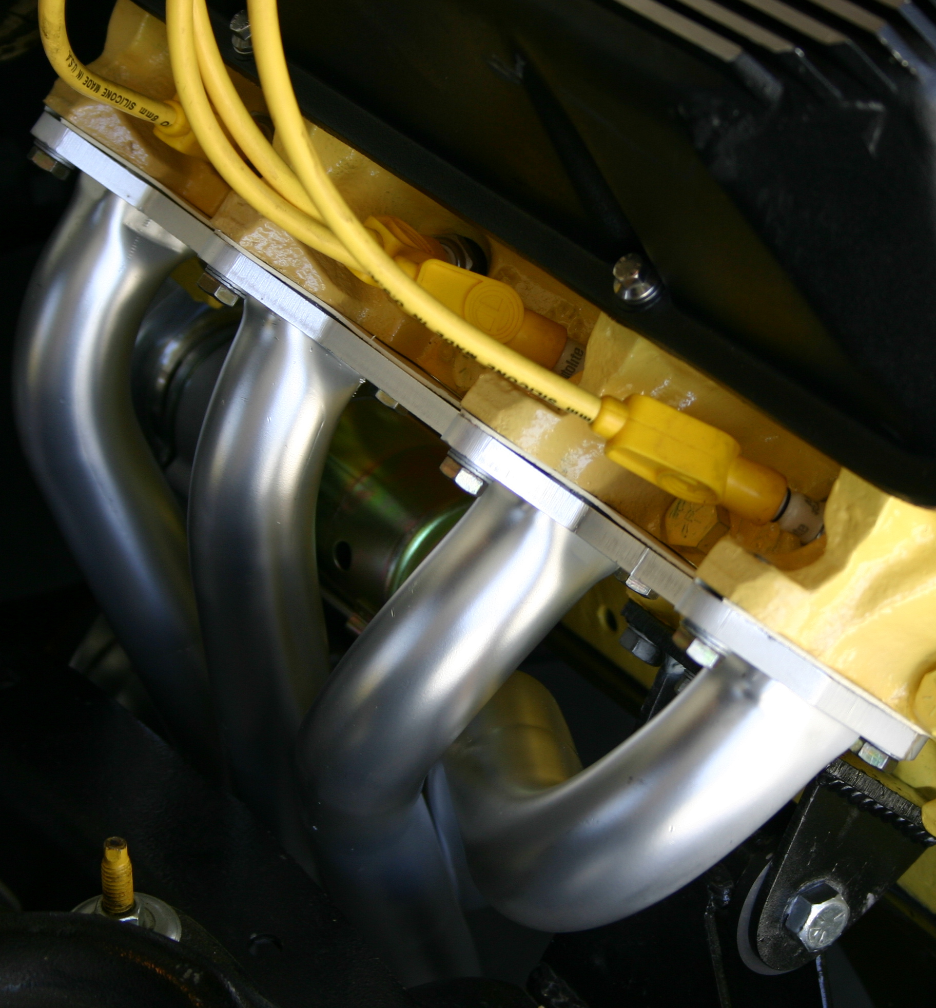

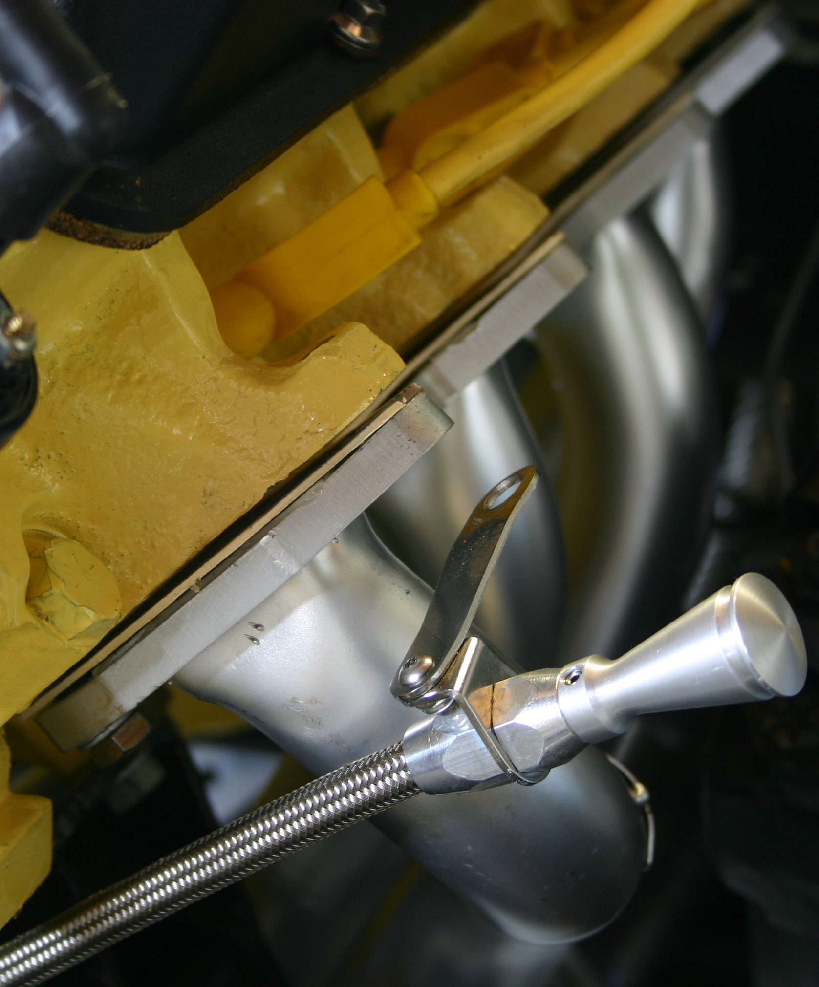

robroy wrote:Unless I hear otherwise, I'll install them with the "Hedman" text facing the heads (so the words aren't visible once it's assembled).
When I went to do this, I was amused to discover that the opposite's true; it's the side facing the headers that's invisible!
Here I just dropped the gasket in, on top of the bottom bolts on #5 and #8. Whoever came up with those slots on the header gaskets that allows them to be dropped in like this really had a great idea.
I could sneak the torque wrench on to all four upper bolts, and the lower bolt on #5--the other three bottom bolts I had to hand-tighten. While using the torque wrench I set the bolts to 15-17 ft/lbs.
And there it is!
Thanks for the fantastic advice!

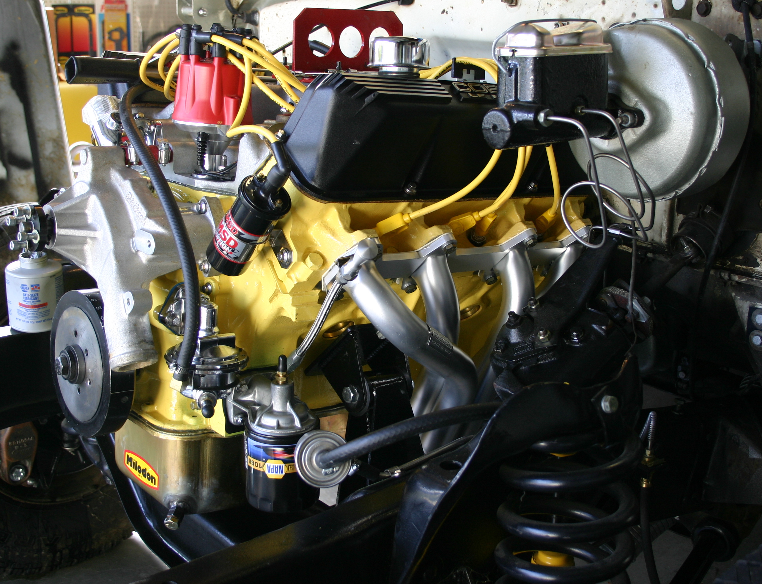

Re: Rough head exhaust surfaces, gaskets, and avoiding leaks.
Good afternoon!
Yesterday I got the passenger's side header on; it sure is a lot easier to deal with!
Thanks again for all the fantastic help!

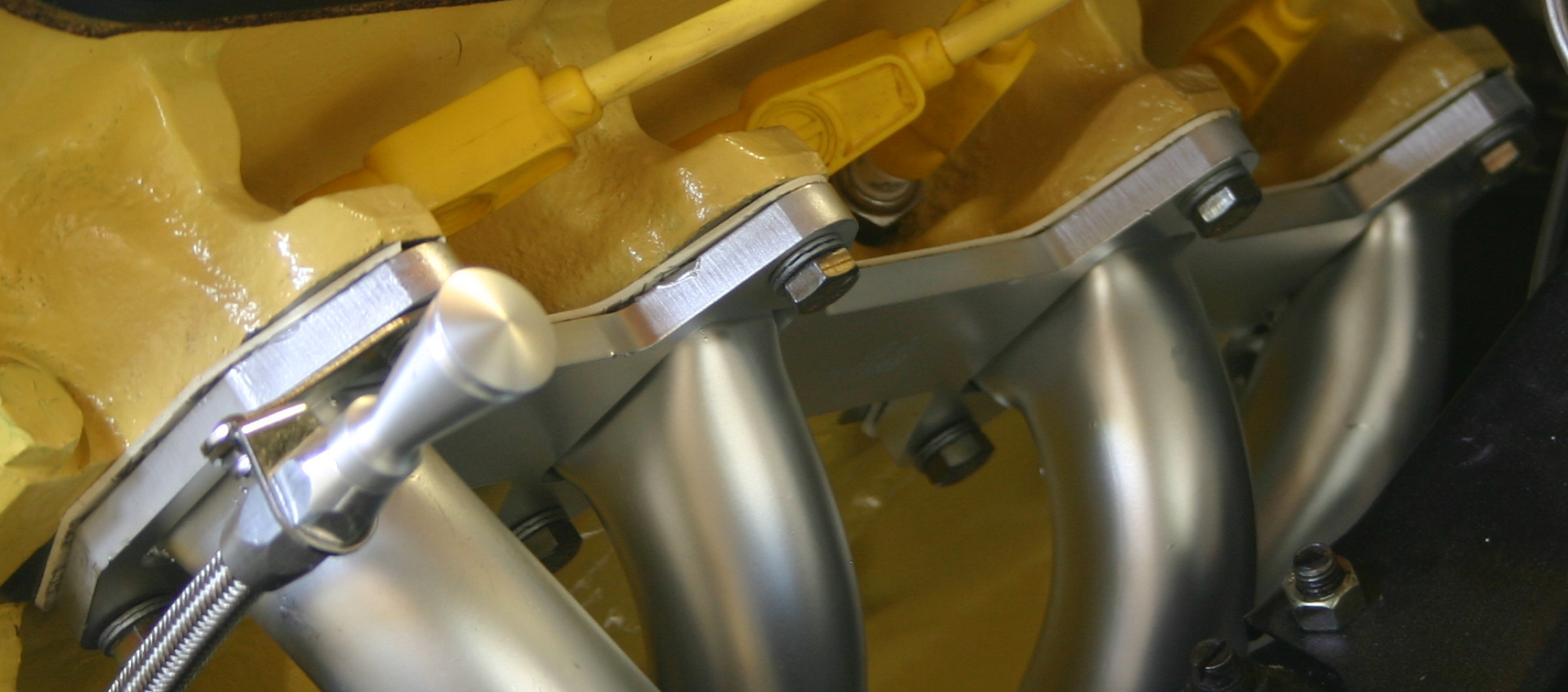

Ranchero50 wrote:Nord locks won't let those bolts go.
Excellent! As (I think) you can see in the latest photos, I used Nord-Locks this time around also.
