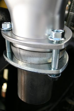

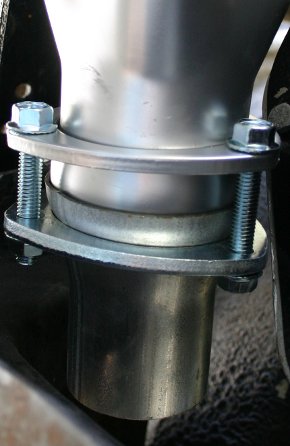

Re: Is it feasible to construct a temporary exhaust system?
Good afternoon! Thanks for all the ultra fantastic replies!
After rummaging around in the stuff that came with the headers, I found what I believe are ball and socket joint parts, and I put them on the collectors. Now it looks like this (the driver's side is on the left):
This seems to adapt the outlet of the headers to a regular, 2.5" pipe. This simplifies things a lot! I think I no longer need special Header Mufflers for my temporary setup, if I use these adapters.
I have a few new questions about this:
- Are these adapters designed to be used in this fashion (I know this might seem obvious, but I thought I'd check).
- These ball and socket couplings seem to allow me to swivel the coupling outlet around quite a bit, which could help me get a correct angle for clamping some mufflers directly on to the pipe. Is this type of connection designed to seal correctly at a variety of angles? Or does it really have to be dead-on, with very little angle involved?
- How tight should I make those bolts that hold the ball and socket couplings together? Does the pipe actually crush a little bit to make the seal?
- I notice that the pipe on the outlet of the couplings (the straight, 2.5" pipe) is neither squashed nor enlarged, so it's not clear to me how they intend me to slip a muffler right over the pipe. Maybe they didn't intend this at all! What's the deal? Do I need to somehow enlarge the inlet on the mufflers I use to fit over that pipe? Or do they come that way?
