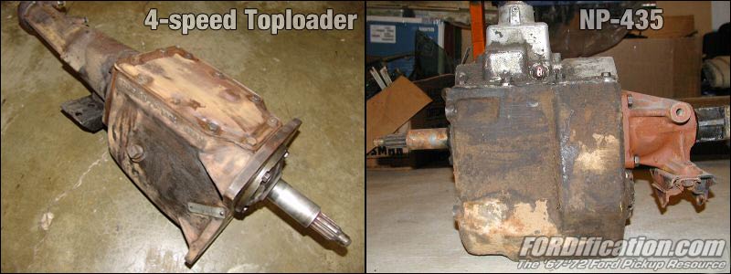

Ya, thats a good price if it works and the syncs arn't shot. Is it a T18 or NP435? If the reverse is down then it is a 435.
I don't think it would bolt into a car very easiely. Might be to tall.

It would definitely be too tall....and you really don't want a granny-gear truck transmission in a car:

Keith, is that your 435? Why do you have a 4wd tailhousing? That is what that bolt hole is for, the shifter. Hard to find when you need one.

No, that's just a reference pic I saved off E-bay.
