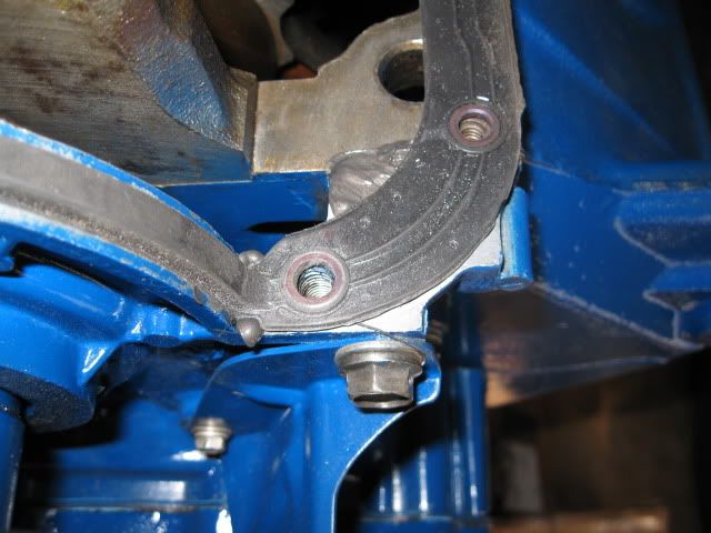

You can use the newer one-piece rubber gasket from Ford, you just have to take a dremel tool and open the metal rings up a little in the corners.
I only used a little ultra black in the corners, otherwise the gasket gets installed dry. A lot of guys remove the metal rings in the corners because they are metric size but you can carefully enlarge them.
