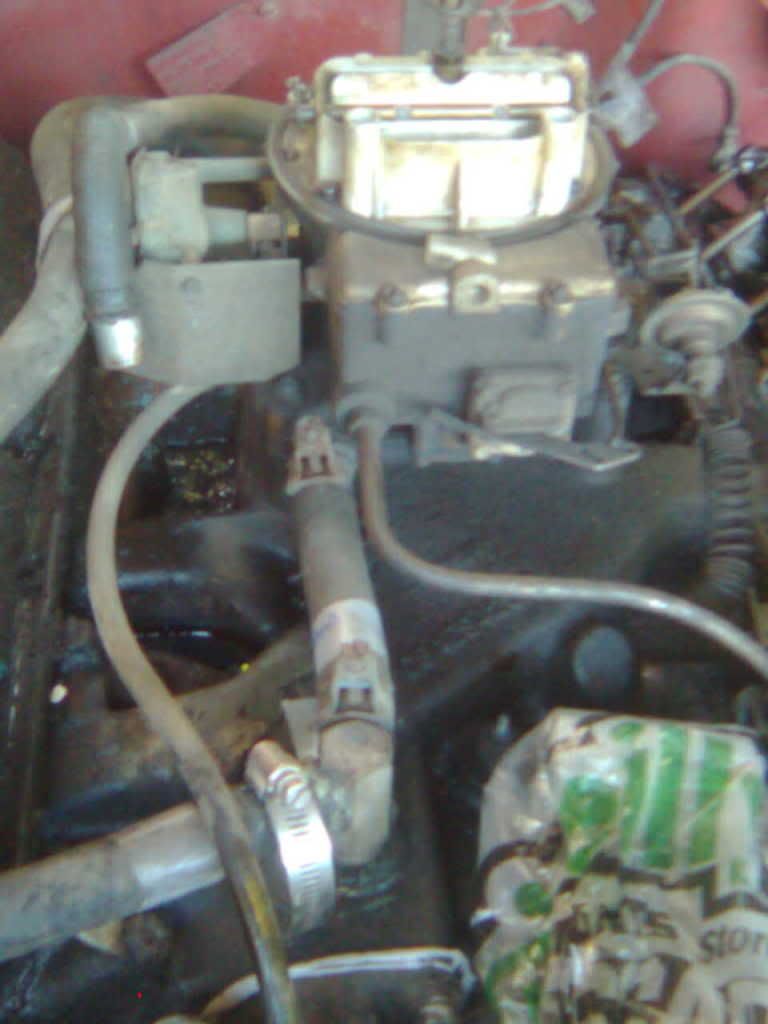

I want to change the stock 2bb on my 360 to a 4bb I was thinking that i could just use the intake and carb from any 67-72 360-390 but im not sure could you guys give me some input on the swap

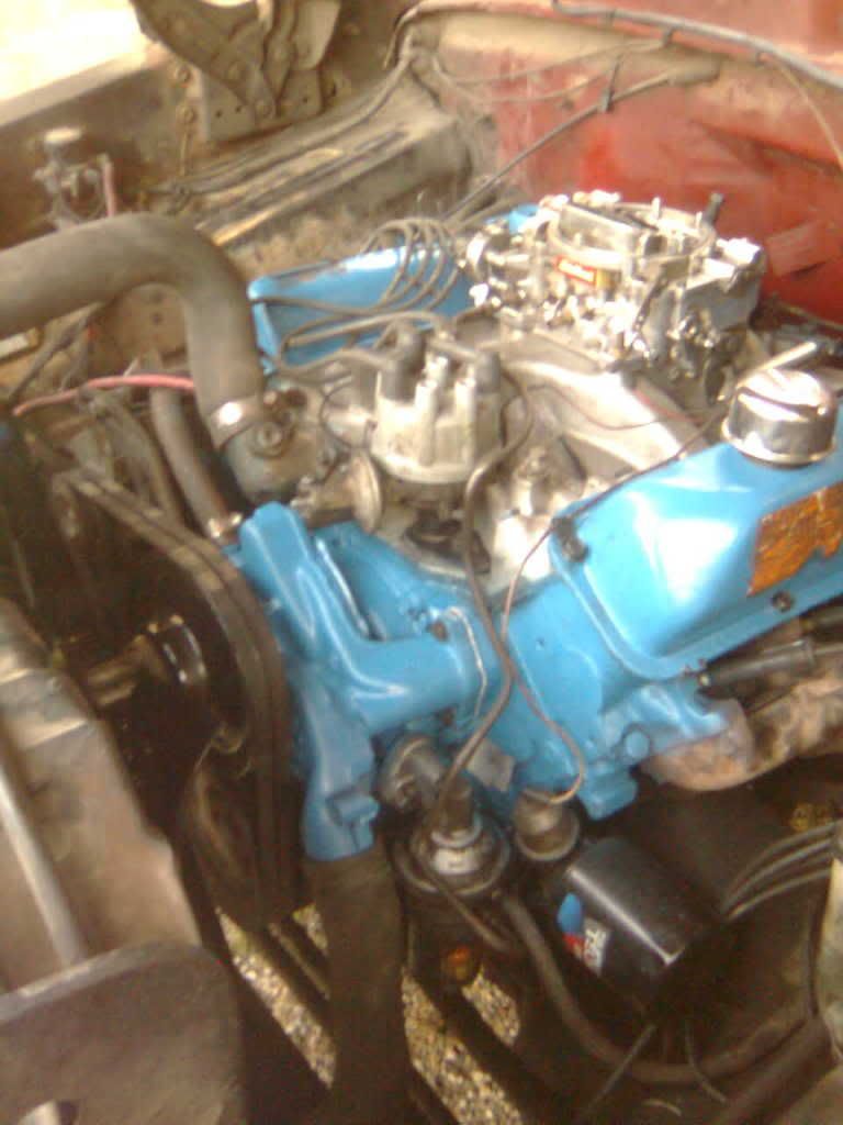

from a 390 to my 360
- Posts: 39
- Joined: Mon Jul 07, 2008 8:26 pm
- Location: ogden, ut
Re: New Intake and carb
i myself still have issues...carb. linkage(still using the holley or whatever linkage was stock)... and i need to set the carb up to work for what this truck needs(in process of dual ex.).... it does run... and actully runs better when it was pulling stuff to this house i moved into later last year...
but, one question i have is. "how would one go about setting them knobs up front?" and is that the extent of it.
