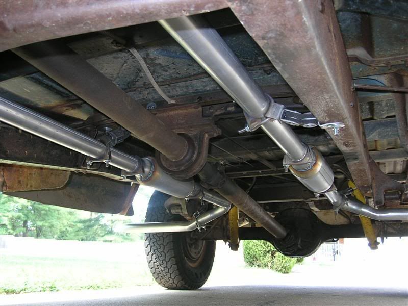

When my engine is cold and I start it condense water comes out of both exhaust tips, left and right. But there comes much more water out on the driver side than on the passenger side.
You can see it here:
Driver:
Passenger:
What does that mean? Is my exhaust not even or is it clogged somehow? Or is this unimportant?

I am sure it is just condensation but not sure why one side is more than the other. Maybe one side is more open than the other I don't know but I wouldn't worry too much about it

My motorhome does this very noticeably. When putting duals on it, I had to route the two sides a little different from each other. The complete exhaust system is VERY long, so it would hold tons of moisture. The right side has a much greater dip (low point) than the left and it always had more moisture to dump.
I ended up getting two cast iron "drain sections" (cast exhaust section with tiny drain hole in low spot) for tractors and installing them. Wouldn't go so far as to do this on my truck, but the motorhome sits for long periods of time and I didn't want to rust out my exhaust.
Not gonna say that's the answer of answer, but I suspect something simular.?.?
