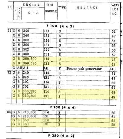

From the MPC:
This shows that the exhaust system parts for '71 and '72 F100 4x2 trucks are listed in Parts List Numbers 48 and 49, while '70 F100 4x4 parts are in List Nos. 58 and 59:

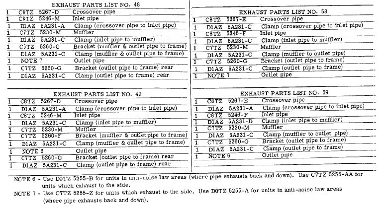

...and here are those four Parts Lists:
